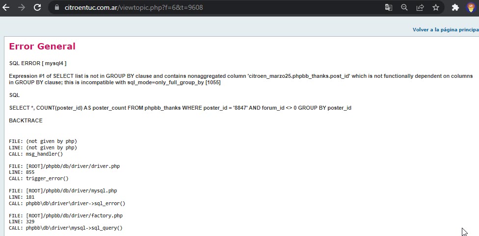

Hola amigos!
Hoy entré a mi foro normalmente y veo que tenia algunos temas nuevos sin leer. Cuando intento entrar a esos temas desde el Subforo en el que se encuentran me salta en siguiente error;
Error General
SQL ERROR [ mysql4 ]
Expression #1 of SELECT list is not in GROUP BY clause and contains nonaggregated column 'citroen_marzo25.phpbb_thanks.post_id' which is not functionally dependent on columns in GROUP BY clause; this is incompatible with sql_mode=only_full_group_by [1055]
SQL
SELECT *, COUNT(poster_id) AS poster_count FROM phpbb_thanks WHERE poster_id = '8847' AND forum_id <> 0 GROUP BY poster_id
BACKTRACE
FILE: (not given by php)
LINE: (not given by php)
CALL: msg_handler()
LINE: 855
CALL: trigger_error()
FILE: [ROOT]/phpbb/db/driver/mysql.php
LINE: 181
LINE: 329
CALL: phpbb\db\driver\mysql->sql_query()
FILE: [ROOT]/ext/gfksx/ThanksForPosts/core/helper.php
LINE: 752
FILE: [ROOT]/ext/gfksx/ThanksForPosts/event/listener.php
LINE: 181
CALL: gfksx\ThanksForPosts\core\helper->array_all_thanks()
CALL: gfksx\ThanksForPosts\event\listener->viewtopic_handle_thanks()
FILE: [ROOT]/vendor/symfony/event-dispatcher/EventDispatcher.php
LINE: 184
CALL: call_user_func()
LINE: 46
CALL: Symfony\Component\EventDispatcher\EventDispatcher->doDispatch()
FILE: [ROOT]/phpbb/event/dispatcher.php
LINE: 60
CALL: Symfony\Component\EventDispatcher\EventDispatcher->dispatch()
LINE: 46
CALL: phpbb\event\dispatcher->dispatch()
FILE: [ROOT]/viewtopic.php
LINE: 1194
CALL: phpbb\event\dispatcher->trigger_event()
Qué pasos debo seguir para solucionar este problema? Muchas gracias

Re: Error al intentar abrir los temas del foro
Puedo entrar perfectamente al panel de control, y en la opción de "configuración de adjuntos", me salta el siguiente debug
[phpBB Debug] PHP Warning: in file [ROOT]/includes/functions_acp.php on line 586: file_exists(): open_basedir restriction in effect. File(/usr/local/bin/) is not within the allowed path(s): (/home/citroen/:/tmp/:/var/tmp/:/opt/alt/php74/usr/share/pear/:/dev/urandom:/usr/local/php56/lib/:/usr/local/php74/lib/:/usr/local/php72/lib/:/usr/local/php70/lib/:/usr/local/php56/lib/:/usr/local/lib/php/)
[phpBB Debug] PHP Warning: in file [ROOT]/includes/functions_acp.php on line 591: file_exists(): open_basedir restriction in effect. File(/usr/local/bin/) is not within the allowed path(s): (/home/citroen/:/tmp/:/var/tmp/:/opt/alt/php74/usr/share/pear/:/dev/urandom:/usr/local/php56/lib/:/usr/local/php74/lib/:/usr/local/php72/lib/:/usr/local/php70/lib/:/usr/local/php56/lib/:/usr/local/lib/php/)

Voy a hacer una aclaración sobre el segundo error.
Ese error no indica que el archivo functions_acp.php no existe. Lo que indica es esto:
Tu hosting tiene el parámetro "open_basedir" establecido, lo cual te limita los directorios con los que puedes interactuar.
En esa página del acp, en alguna de sus opciones tienes puesta la ruta "/usr/local/bin/" a la cual no puedes acceder. Deberías quitar eso de la configuración.
Sobre el primer error.
El hosting a actualizado la versión de mysql o su configuración. Han establecido el modo "only_full_group_by" y por lo visto, la versión de la extensión "thanks for post" que usas no es del todo compatible con eso.
Te diría que tienes que actualizar la extensión, pero creo que las nuevas versiones no son compatibles con tu versión de phpBB.
Yo he estado buscando pero no he encontrado esa versión de la extensión para poder mirar. La única forma de ayudarte sería que adjuntaras tu extension "Thanks for post" para poder probarla y modificarla.
PD: Lo ideal para no tener estos problemas sería actualizar el foro y con el todas las extensiones, pero creo recordar que tu tenías algun problema con eso (no se como está el tema)
