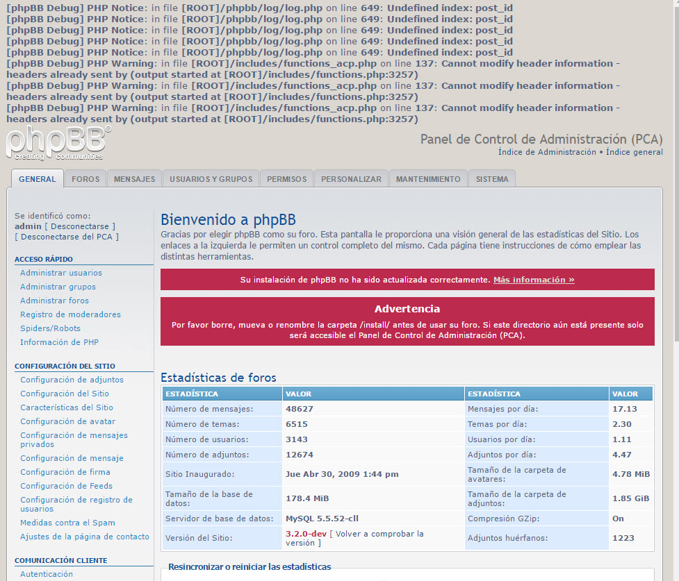

Intenté entrar al foro y al acp donde se me abrió un aviso del DEBUG
Quizas sirva de algo esta info
Aqui dejo el DEBUG:
[phpBB Debug] PHP Notice: in file [ROOT]/phpbb/log/log.php on line 649: Undefined index: post_id
[phpBB Debug] PHP Warning: in file [ROOT]/includes/functions_acp.php on line 137: Cannot modify header information - headers already sent by (output started at [ROOT]/includes/functions.php:3257)
